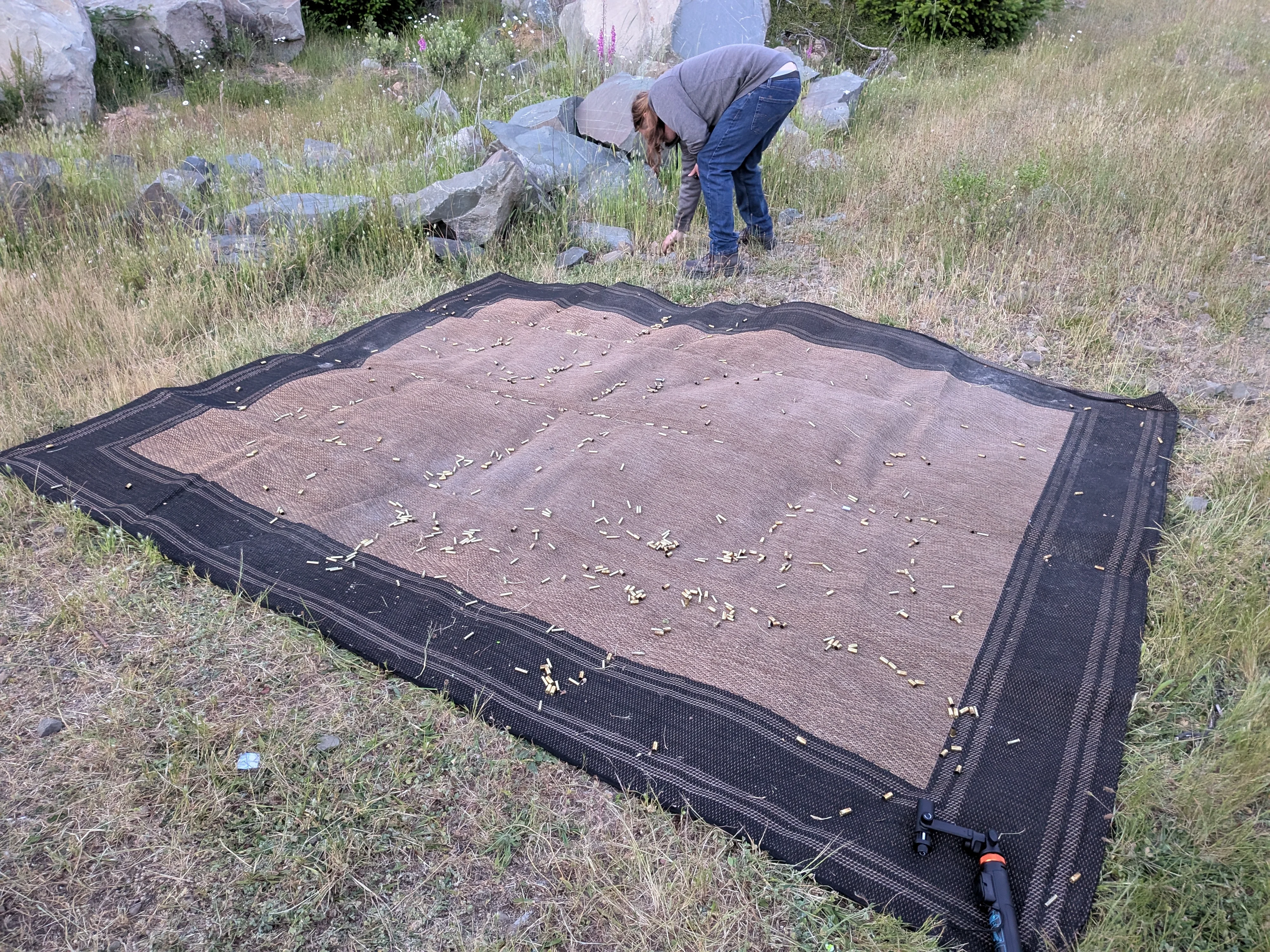

There is our very own Gold Member ST and friends shooting on a large area rug and police ing his brass out in Mother Nature. This kind of behavior reflects well on the shooting community. Leave no trace. Good on you zisr! This keeps areas from being shut down to shooting. It really helps.

The rug is an important part of our shooting gear, we never shoot without it.

Yep, I have done this many times myself but typically use a plastic tarp (easier to handle) .

We think the rug is classier ;)
We only shot 360 rounds 9mm, 240 rounds 30sc, and 500 rounds WMR yesterday (we got a late start). We loose more 30sc than anything as none of them are consistent at location of ejected brass - that's what jr is in the ground looking for.

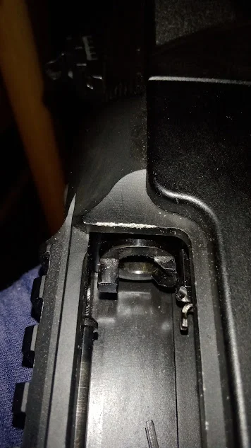

So do I ! However to be more specific when I first got it, it shot well and accurately but was ejecting brass inconsistently and at first I didn't think much about it until I started noticing the forward edge of the ejecting port beginning to show bare alloy and I realized some cases were striking it.

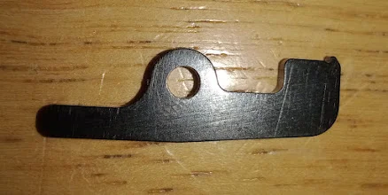

Well, I began to look into it and realized this was a common problem. Part of it is/was the extractor and I discovered it was due to the 'hook' on it being very short and they were wearing fairly quickly, hence Ruger sending me a new one. The original can be temporarily fixed by filing the metal down in front of the hook and increasing it's length but it will probably not last.

Here is the wear on the ejector port from the brass striking it.
Here is the original extractor AFTER filing. The hook was pretty well worn down. I never tried it as I contacted Ruger and they sent me new one.
