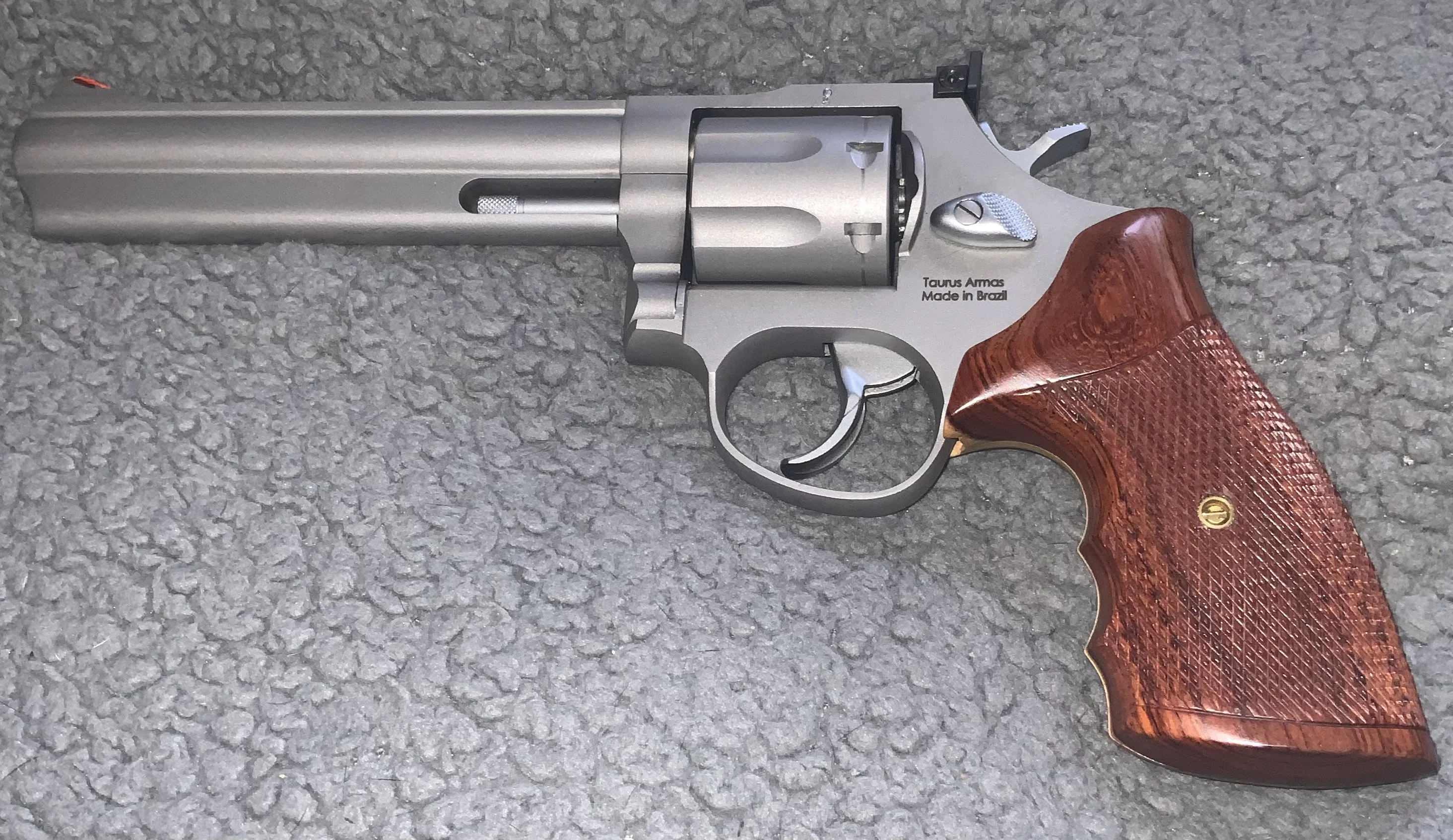

I have been picking up guns from my past for nostalgia’s sake, and when I do they are usually cheap. For example, the first handgun that I ever purchased was a Taurus Stainless 66 revolver. I just picked up a 2 year old one, like new for $400 bucks, with really nice wood grips.
Great looking Taurus! Hows the fit & function?
An early Glock 17
None
Well, nothing specific exactly. I guess if ALL I thought about handguns was that they were first and foremost for self defense ONLY then I guess I MIGHT say I like the lightweight factor of them for carry but comparatively speaking to all steel guns AND the fact I do NOT simply regard handguns for self defense only I cannot say I like anything specific about them.
I seem to be having a lockup issue. One cyl has a primer strike off center when firing double action. Going to see if the ejector rod is gunned up. All primers struck dead center on single action.
Check the 'hand' or 'pawl' as it is sometimes called.
These can wear quickly if not properly fitted will NOT properly rotate the cylinder into the proper position.
Try this as well. WITH THE CYLINDER EMPTY Hold your finger lightly on the cylinder to let it 'drag' when you are cocking it. Once the hammer is locked slightly try to move the cylinder in the direction it rotates. If it moves and 'clicks' into the locked position this is possibly a worn 'star' as well.
To double check this load six EMPTY brass into the cylinder and try this again. If it locks properly on each cocking of the hammer then it's most likely a worn 'Star'.
Well I checked that. I put in some new snap caps. All strikes in the center. Also the ejection rod is dirty. So I will give the gun a proper cleaning. The previous owner had only cleaned the barrel.
I think part of the problem is that I have arthritis and my hands aren’t very strong. I wasn’t pulling the hammer back hard enough sometimes. If I pull back hard, I can get it to index properly.
I will start with some soft staged lead .38’s the first time I fire it, just to make sure it won’t be spitting. I think it will be ok. Also there is no cylinder movement after dropping the hammer double action or single action when running it empty. These grips are really nice. I will have to see if they fit my Python.
The hand looks perfect by the way. The previous owner had only shot a few boxes of 38 through it. It’s a 2024 or 2025 model, but he may not have been the original owner.
Sounds like a complete teardown, COMPLETE cleaning and properly lubed is in order.
Some of the Non US gun Mfgs. use 'mystery lube' on their new guns and it's not intended to be left on after delivery but some don't understand this, don't give the new gun a COMPLETE cleaning and it can turn hard, almost clay like and cause problems.
I learned RIA uses Cosmolene but it is water soluble and a boiling of all parts removes it.
Bottom line is a lot of people 'cuss' Taurus but all those I have seen looked and operated great!
I only had ONE once, a 2" Mod 605 Snub and it looked great and everything well fitted and it was very accurate!
