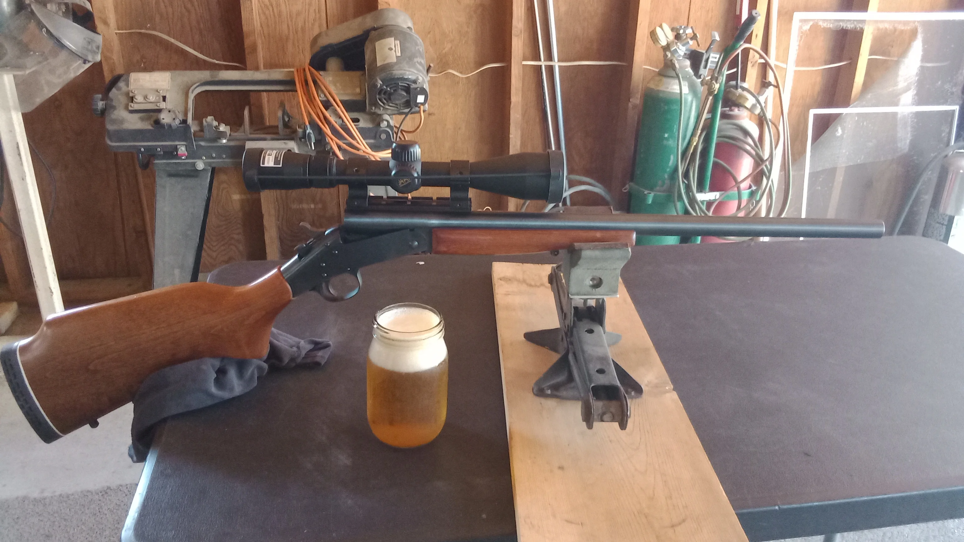

Here is a recent 'zeroing' of my NEF Handi - Rifle with a new scope and rings. Oh, no ammo nearby and in my shop so the 'beverage' was acceptable!
That’s a great walk-through, and a solid example of true old-school bore-sighting!!! Thanks for sharing
